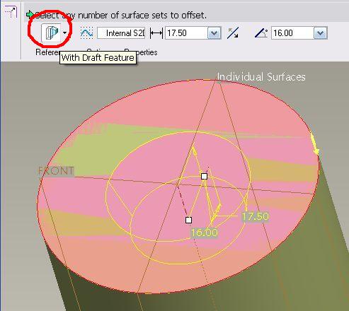

I am using Pro Engineer Wildfire 4.0 education version. I was following this tutorial (http://www.me.cmu.edu/academics/courses/NSF_Edu_Proj/Wildfire_short_course/tutorial10.htm ) and was at the creating features part when it ask me to use offset with draft. For some reason, there is no option to offset with draft. I've tried looking around and other methods, but can't seem to find anything. Does anyone have any suggestions or has encountered this problem before? Thank you.

Not sure what version that's from but here is a what you need to select in WF4:
