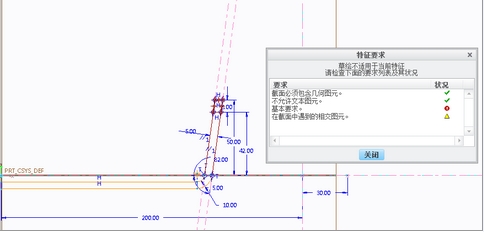

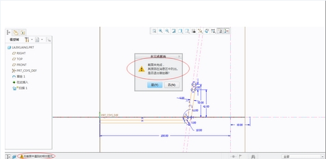

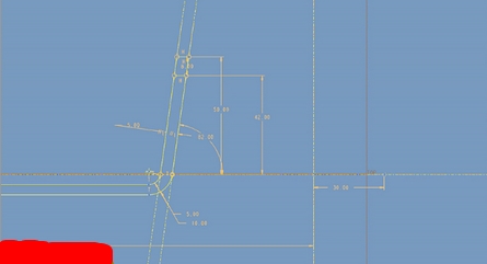

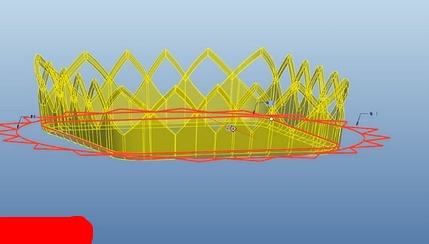

I met a problem using Creo3.0, and I am asking for your help now.
When I did the following practice[1]with Creo3.0(While the theacher in this video used ProE Wildfire.), I
couldn't do the same step as the pictures[2]show and the after. So I am asking you if there is a bug in Creo3.0 or
there is some way to complete the model in the video with your Creo3.0?
[1] The practice vedio link:
http://v.youku.com/v_show/id_XNzgyOTQ0MDM2.html
[2] The pictures are as follows:
(a) using Pro Widlfire5.0 this step and the after could be done successfuly
(b) do the same practice wtihe your Creo3.0, it couldn't be completed and the software gave these tips as the pictures.
And I asked some of my parteners and teachers, they met the same problem. And it seems difficult to solve, so I choose to ask you if you have met the same problem and how you solve it.

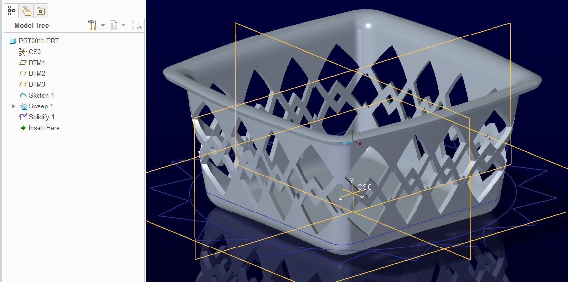

Interesting model, but I cannot quite follow the video. I get the idea, however. Maybe Creo will not allow the crossover that happens with the "weave".
Edit: Did you try to create this as a surface model or a solid? The video is showing surface model geometry for the sweep feature.

This is Creo 3.0 M020. Notice I used a separate solidify after the sweep.
