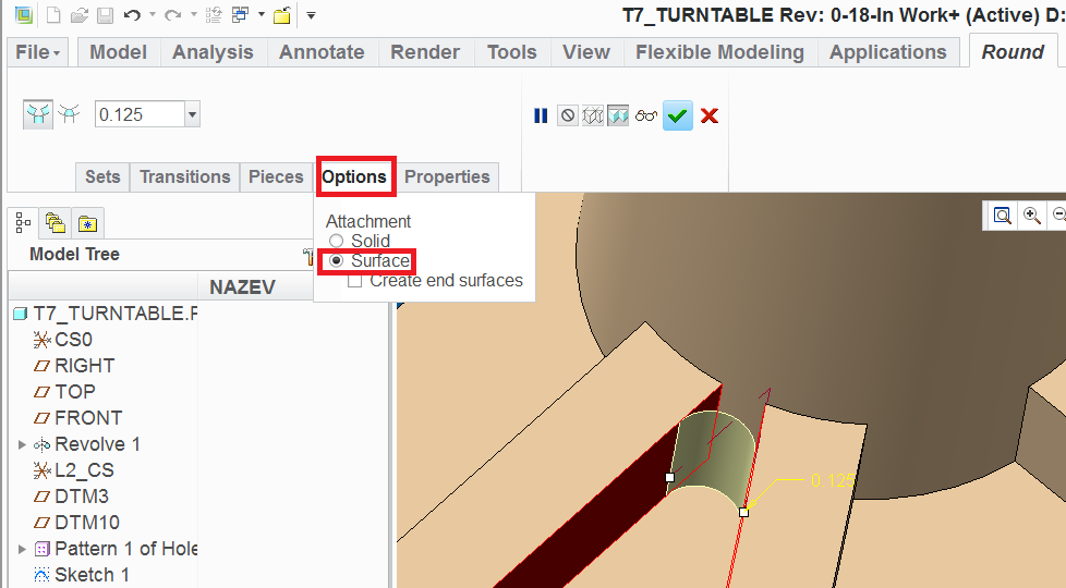

Mark,
I think you cannot create Round as Solid feature. Create it as Surface and close the space between round and model geometry.
MH

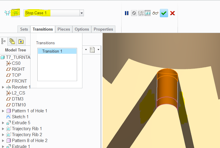

September 25, 2015
Change the transition stop case...
Click on the red highlight at the top of the preview and the options will be available.
