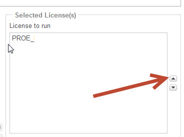

January 23, 2015
Thank you for your help.
When I ran the utility, these were the licenses listed to run:
There were no additional licenses on the left-hand side.

Mahesh_Sharma
22-Sapphire I
January 23, 2015
Ok, you need to move PROE_FlexAdvISD on top priority. Select PROE_FlexAdvISD license in list and use up arrow to move that upside.
January 23, 2015
Now that I have done this, my Flexible Modeling has disappeared. Does one prevent the other from running?
Mahesh_Sharma
22-Sapphire I
January 23, 2015
I think, reason of this is, License for Flexible modeling is a part of PROE_EssentialI and AAX & ISDX are in PROE_FlexAdvISD, so when Creo will launch for sirst time, it will use PROE_FlexAdvISD. In that session you will get AAX and ISDX, if you will launch new session, it will use PROE_EssentialI which will allow flexible modeling.
January 26, 2015
Thank you. This worked.
