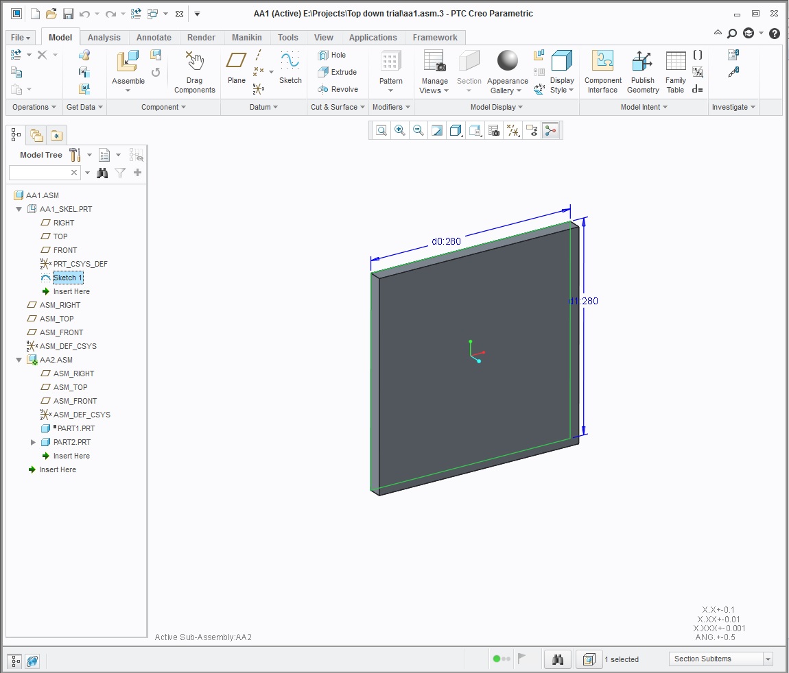

As the assembly model I have created is quite big, I have attached the image and model files for sample case of top down modelling where similar problems observed. In this case there are two parts PART1 & PART2 which are controlled/referenced by skeleton dimensions d0:280 & d1:280.
In this case as PART1 is suppressed I found the regeneration error when I opened that part file. The regeneration errors are not due to assembly constraint but its due to missing references used during extrude definition. Pls go through the model files and It would be grateful if you can help.

your part1 contains geometry referencing the assembly aa1, the sketch of the extrude uses two curves from the skeleton.
Hence the sketcher geometry inside the part depends on the skeleton geometry, but also on the placement of part1 and the skeleton (the relative orientation between both makes a difference)
The problem in your example is, that the part currently is not in the assembly (it is suppressed) - hence regeneration fails when it tries to fetch the references for the update.
To make full use of the skeleton functionality (and to solve your issue), you should not reference geometry directly (like in sketcher).
Create a copy geometry feature in the part and copy all geometry you need from the skeleton:
Under the Options of the Copy Geometry feature, you find the section Copy geometry Update, which allows you to decide when you want it to update (and as long as the part is not in the assembly it is no good time to do it).
If you set it to No Dependency it will stay as is and never care of the assembly - if you want it to update you can later change the setting again.
The sketch can then reference the curves in the Copy Geometry feature.
