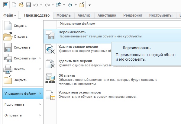

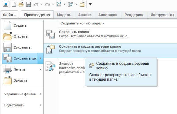

February 2, 2015
1. create a new folder
2. save a new copy of the project folder
3. open a new folder
4. rename all

hey Olga,
this is not a correct answer because only one main assembly drawing copied by this ,else subassembly drawings not copied by this step.
I already tried all this.

save and rename the main assembly drawing?
