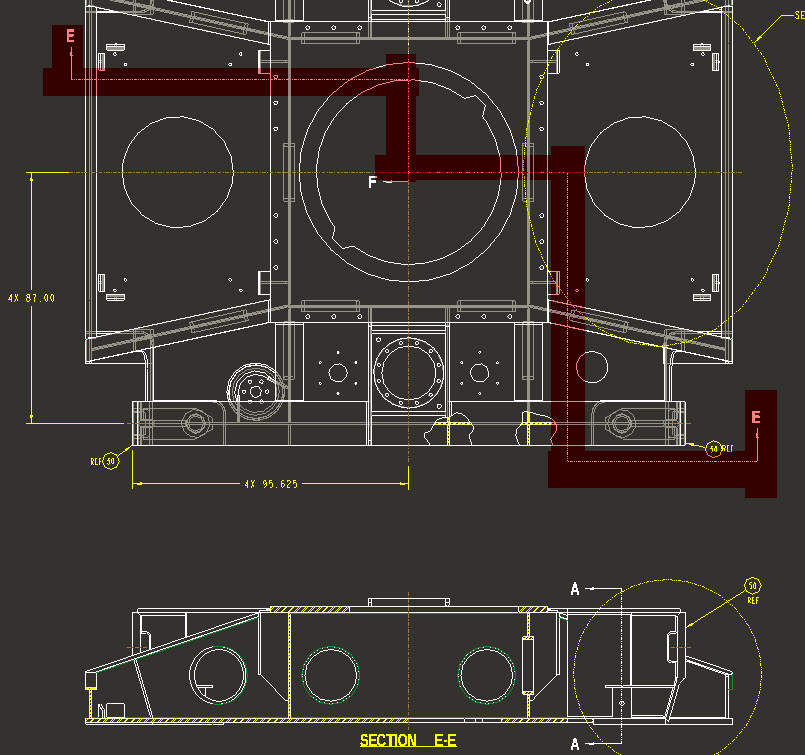

Is it possible for projection arrows in a drw to "show" exactly the way they are sketched in the prt? For instance if the sketched xsection takes some 90deg turns?

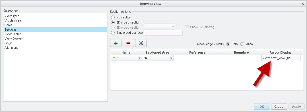

Best answer by StephenW
If you are showing the arrows from the section tab of the view properties, it should show the offset x-sections arrows as you have sketched them.

Thanks for the help too. I have no problem showing the sketched xsec in the prt file, or in the drw for that matter, it's just that in the drw, the Projection arrows do not follow the sketch?

Maybe an example image of the what you are trying to do will help with understanding the issue. What is throwing me is the term "sketch".
