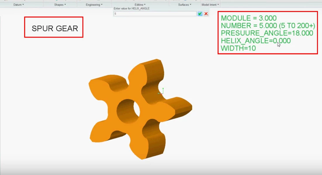

I would like to ask you for some help. The problem is following. I have found in one movie on youtube that the user had projected parameters from his model in the rigth-upper corner in such way, that they were still visible with their values next to each other. He had done the same trick with the name of the model (this time in the left-upper corner). I would like to make the same, however, I have no idea how to deal with this. Did any of you prepared similar thing?
I will be very grateful for your help.
PS.: I attach the print screen from the mentioned movie where I have marked with red frames both elements I'm talking about.
Best answer by Jose_Costa
Wath the video on this post:
help in linking annotation to parameter (or relation)

This is exactly what I was looking for. Thank you very much
