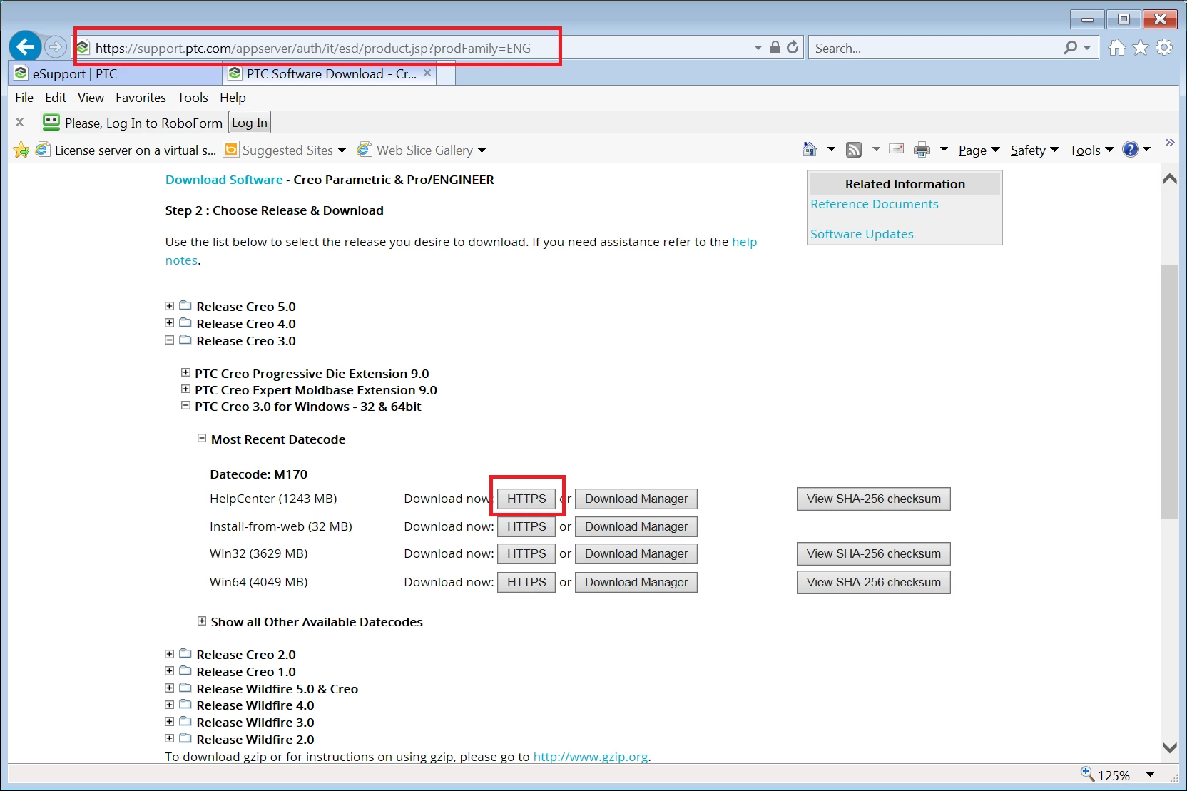

        When we click on the PTC Creo Parametric help icon, we get an error message:
"Creo Help Center on http://help.ptc.com/ could not be accessed. Check your internet access. For offline access to help, install the help center locally. See the installation guide for details"
Could someone help me with the settings relevant to ensure the help icon leads to the correct link for help. We do not want to install the help locally.
thanks
Ananth
Best answer by MartinHanak
1.] download PTC Help installation media (zip file)
help.png2.] unzip zip file
3.] run setup.exe
