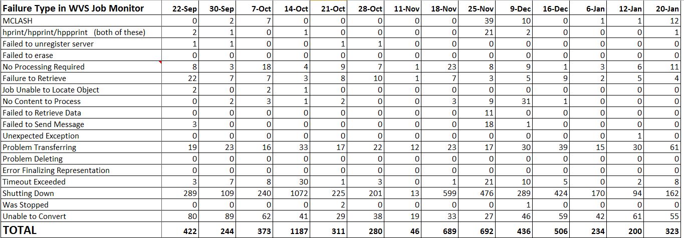

Hopefully you don't see this error very often...we keep track of our failure types and this one is definitely rare. Opening the assembly in master rep as Lance suggests is a good approach.  This appears to be extended positioning assembly type of which I'm guessing you have a unique feature in the model tree that is not yet designed into the adapter.  Will require a case with Tech support more than likely.
