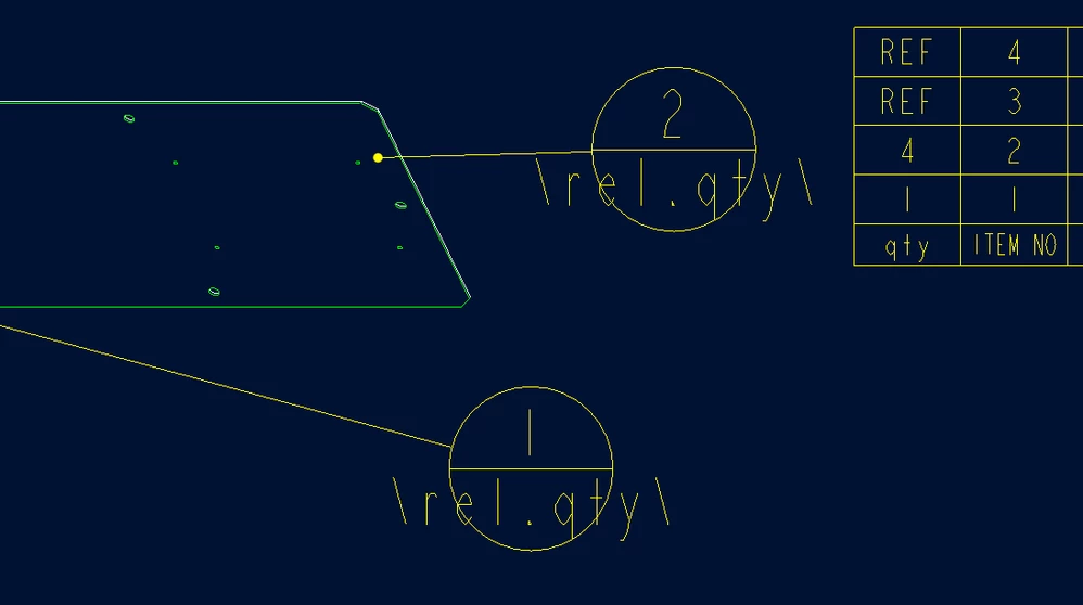

Hi, I use on drawing repeat region with column user defined parameter rel.qty. I need to display my qty parameter in quantity bom ballon.
I tryed to modify bom balloon symbol, but it doesnt work. See attached picture.
Thanks for any ideas.

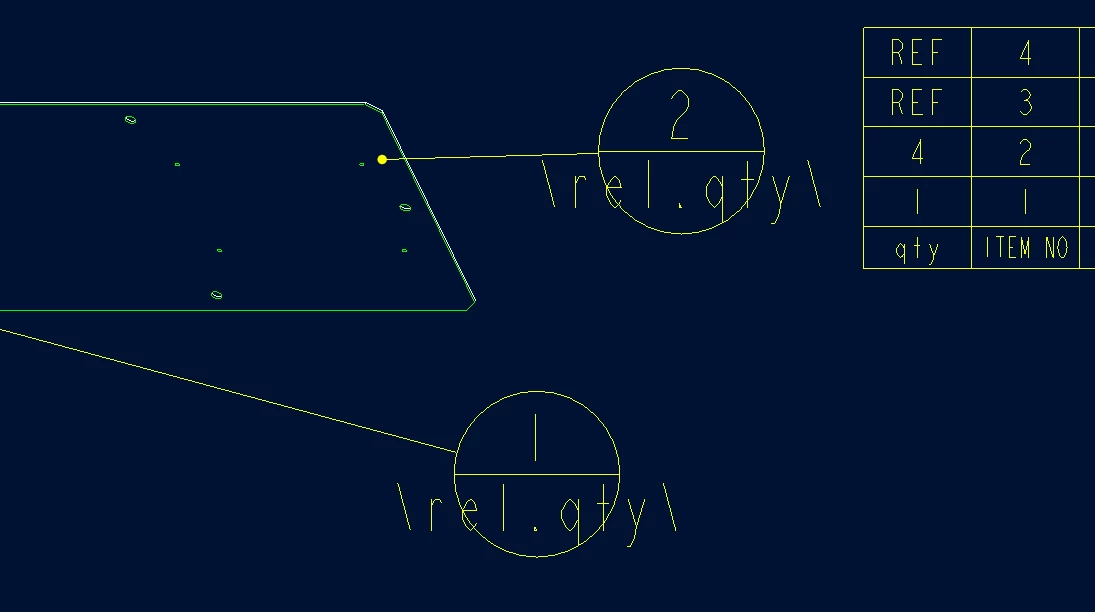

1.) please upload test data packaged in zip file
2.) if you want to use rel.qty you have to define qty parameter in repeat region relation

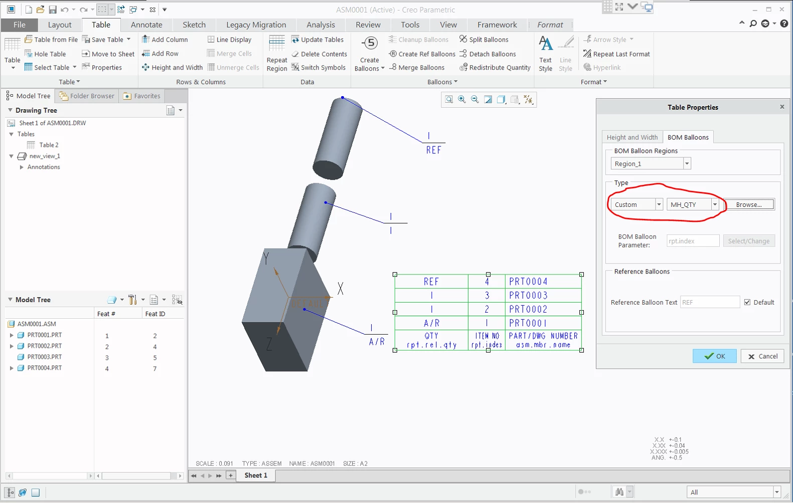

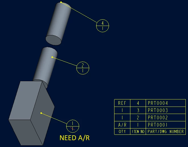

I send test data in attachment. I need to have same qty in bom balloon symbol as it is in table.
August 7, 2018
you have to define BOM Balloon custom symbol. See attached zip file.
