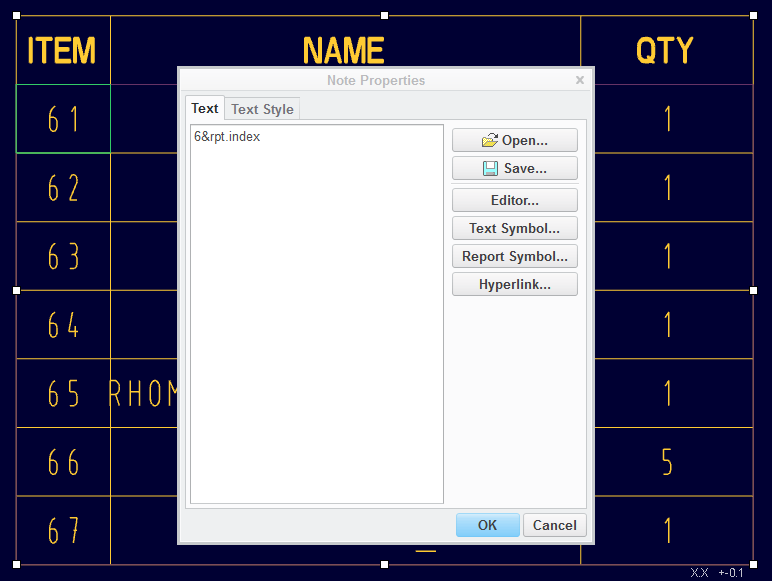

I was able to simply prefix the variable with the number 6...  Highlight the first cell, right click, and select properties.
The dialog in the image should show up.  Add the 6  before the &rpt.index.
I suspect this will be problematic when it reaches 2 digits.  Beyond this tip, I am not familiar enough to guide you through more advanced means of using repeat regions.
