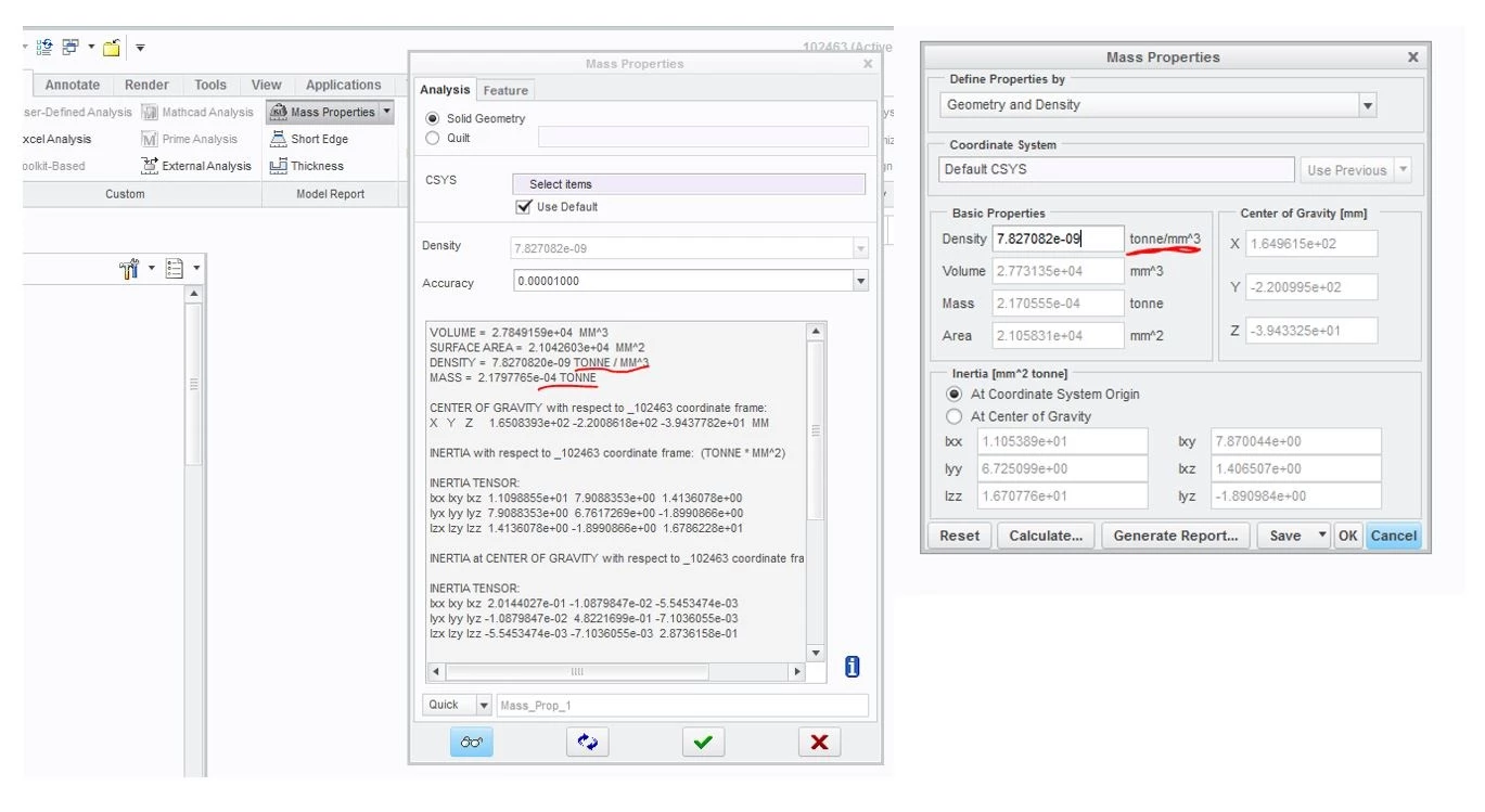

Hello, I have a basic question on displaying mass and density in Creo.  Can change the default unit of mass to Kg when we measure it.  Please see attached file for the details. Even when I change the mass / Density units to Kg / Kg/mm3, but when we measure it on the part level, we still get them in Tonnn / mm3.  Does Creo allow this to be modified to the unit that we want, like Kg/mm3 or gm/cm3 etc..
I am sure there is may be some answer out there for this question, but I could not get access to it.  Creo version is 4.0

Are you actually changing the units in the part? If I change the units in the part, it also changes the units in the mass properties dialogs.

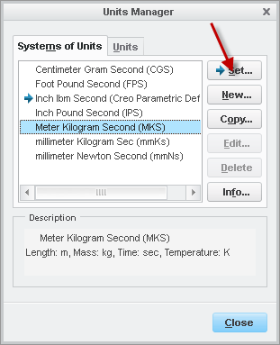

Are you pushing "SET" kn the units manager when you change the units?
fd-21-VisitorAuthor
April 4, 2017
Stephen, Thanks for reply, It solved my question.  When I set this to MKS, I am getting the mass in Kg.

One other thing to point out.  The units will display based on the active model.  If a part is active, the units will reflect how that part is set.  If the assembly is active then everything will display based on that assembly's setting (regardless of how the parts are set.)
