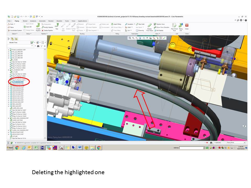

Hi all,
when you make a solid pipe, it has a different icon into the model tree: a green hollow pipe.
If you change its trajectory and you regenarate the assembly also the solid pipe changes.
But if you delete, accidentally, the solid pipe, you cannot re-import the part with the link with the "pipe-centerline". Also the icon of the part is differet and egual to the standart part.prt.
Is there a manner to re-link the solid pipe?
Bye

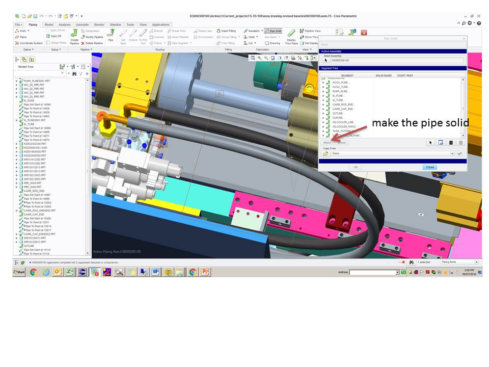

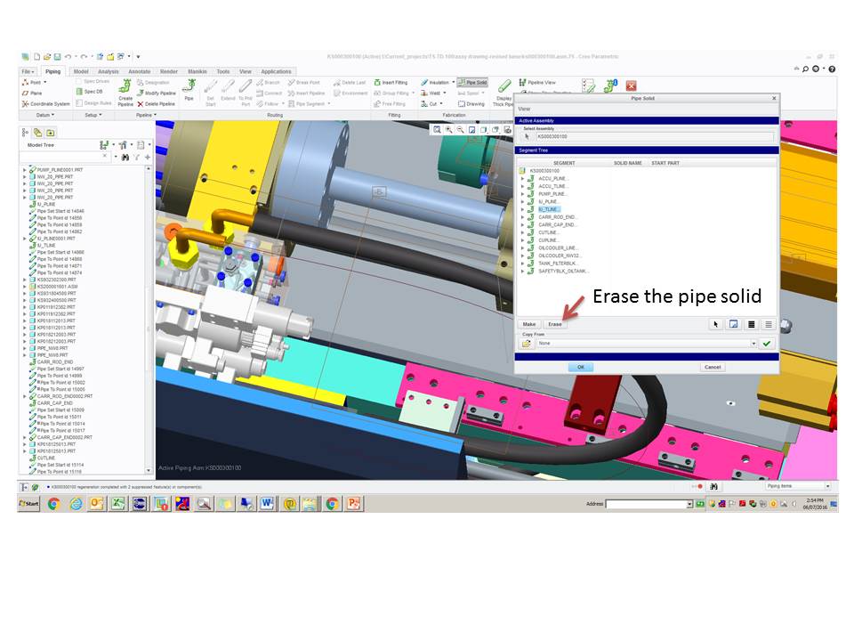

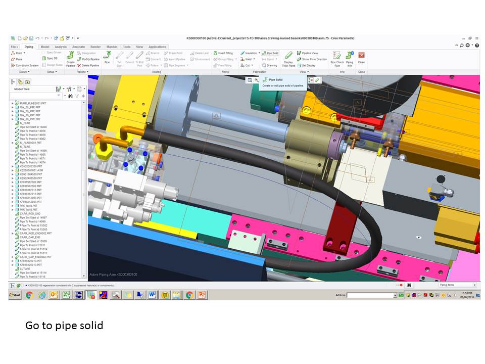

hi,
for example old file.prt is a file which will create automatically while we make pipe solid,it's just part file you can't edit anything.
in piping module you are not assembling the piep solid in the pipe route know.we have to create not to assemble.
