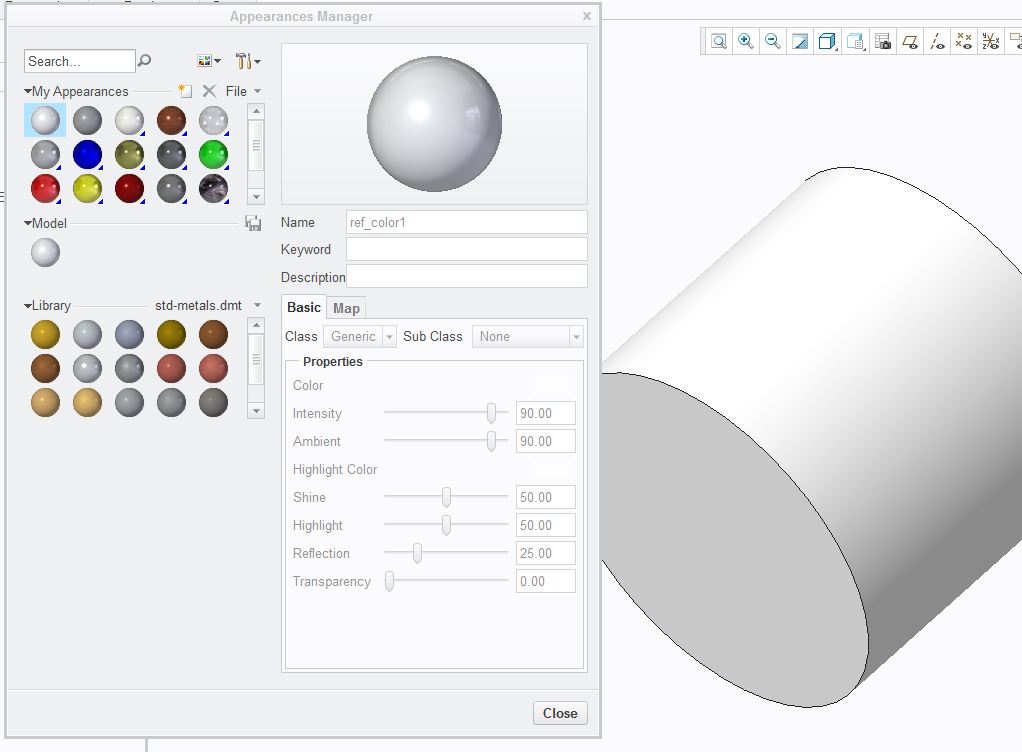

I am using Creo 3.0 M010. My default part color recently changed from some shade of gray to bright white. I cannot figure out how to change it back. I think it occurred when restarting after I changed the edge resolution while working with cylindrical parts. It's pretty bad since we use a white background (to copy images to presentations) and the parts are now barely visible. I've tried changing the RGB or the intensity or ambient properties but they cannot be changed.
The parts starts out with the default ref_color1 which is now white (90% intensity) but I now see another called <ref_color1> that is the gray (white with 60% intensity) I used to have. Why did the system change the default?
Any clues? Thanks.

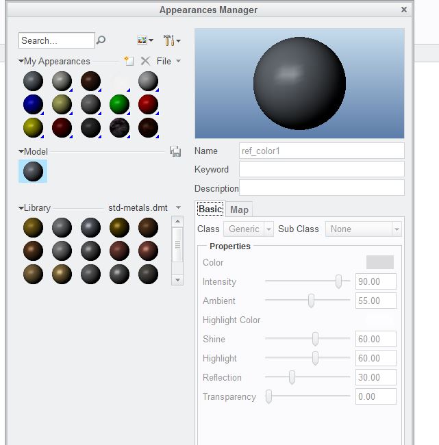

but now all my appearance gallery thumbnails are dimmed. The last time this happened it would crash every time I added color. That was another problem where Creo was accessing an older ProE color file. I see these things are related...Capture.JPG
