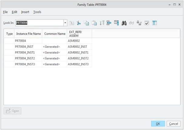

I'm starting a new library of components. I am going to have the following structure typically
Assembly_generic
    PartA_generic
    PartB_generic

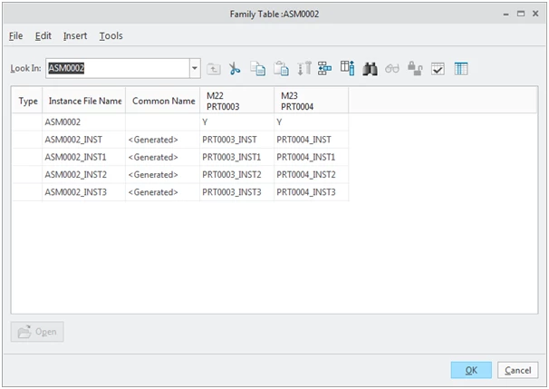

and an instance of that assembly will be like this (in table format):

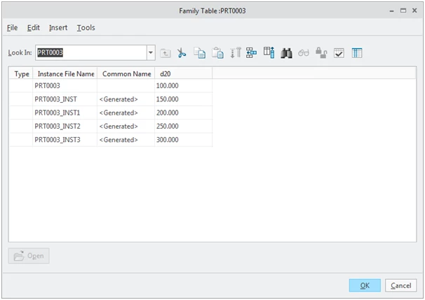

  PartA  PartB
Assembly_INST1 PartA_INST1 PartB_INST1
Assembly_INST2 PartA_INST2 PartB_INST2

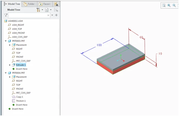

PartA is a normal part with real dimensions that will be accurately modelled. PartB, however represents a consumable material (glue, shim or similar) so that its dimensions actually should come from Part A as well. Currently I have to define the same family table values in the tables of PartA and PartB, but I'm trying to find a way to define the dimensions only once, at the level of part A or at assembly level. Just to make the design clear and easy to update in the future. I want the partB to be a part because it has significant dimensions and properties for the BOM.
I've tried to define a sketch at assembly level and put its dimensions in the assembly family table, to use them as the master, but it doesn't work (see attached parts). And I think that the same will happen with an skeleton. I have also tried to use notebook params (for the first time) but I didn't get it either...I realised that params cant be used as values of my instance columns... Any idea or a different approach? Is this just not possible?
Thank you!
Carlos
Best answer by jbutler-2
You need to use the 'reference model' column in your 'glue' part family table. This type of column tells the instance of the part which instance of the assembly it should be regenerated in the context of.
In my experience this can be difficult to get correct if you're copying dimensions using relations, as session IDs will sometimes stay 'stuck' to the generic. I think it will be more robust if you use copy geometry features.
8-Gravel
March 26, 2019
It is exactly what I need!
