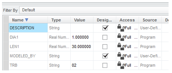

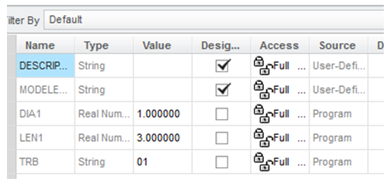

Thanks MH.  I've built a very simple part in Creo3 to try to understand what is going on.  The part takes a string parameter, "TRB" which for a value of "01" turns on a cylinder driven by a "DIA1" parameter.  For "TRB" == "02, the cylinder is turned off and a rectangular protrusion is turned on, which has one of it's sides driven by a "LEN1" parameter.  here's what the INPUT section looks like and these are typical part parameters:
The part is currently saved with these parameters:
The parts that I am having issues with are very complicated and there are some other parameters that are not being updated but I think it might be because they are not in the INPUT section.  Unfortunately the INPUT section is many pages long with multiple nested loops, etc. so there's a lot to sort through.  Making simple parts to test the logic is sometimes helpful.  I've got a couple of other ideas to try next...

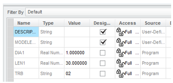

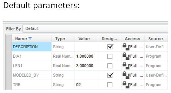

Well, I discovered a difference in this functionality between parts created in Creo2 and parts created in Creo3.
Part created in Creo2 example:  part saved with the rectangle feature turned on (TRB = "02") and these values
Note that the LEN1 parameter updated even though the TRB parameter came after it in the input file.  Is it because the default was already set to "02"?  Let's find out...

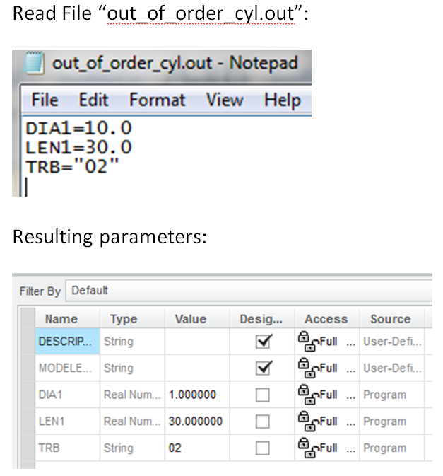

After reading in the exact same input file, the LEN1 parameter still updated even though the TRB parameter came after it in the input file.  This is good and works as I think it should in Creo2 and Creo3 WITH A PART THAT WAS CREATED IN CREO2.  I even saved the Creo2 part in Creo3 and the test results were the same.

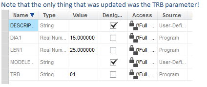

Next I created the same simple part in Creo3.

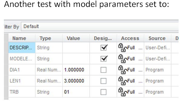

Results look the same as in the Creo2 part, but the LEN1 parameter was only updated because the default for TRB was already "02":

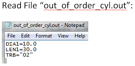

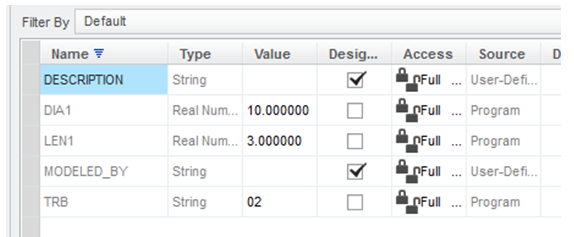

Changing the parameters to this for another trial, just as I did on the Creo2 created part:
After reading in the exact same input file I get a different result!  This time the DIA1 parameter updated, I guess because the default value for the TRB was "01" and this time the LEN1 parameter did not update!  The rectangle was turned on, but the value driving the feature was the default value of 3.0 instead of 30.0 from the input file.

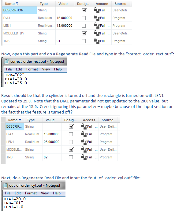

Thanks for the suggestion, but I need the logic around the INPUT section as most of the time Regenerate Enter Select All functionality is used and the users depend on this to know which parameters are needed.  Reading from the .txt file only happens 40% of the time.
It's strange that by creating a part in Creo3, the functionality of this is different than creating the exact same simple part in Creo2.  In my situation, I have very old parts that only had some features (unrelated to issue) added in Creo3 and the functionality changed.
Preparing files that follow the order of the INPUT section will work, but the files are being exported directly out of Creo and it seems that the order of the parameters comes from the order in which the parameters were created.  It will require some extra programming to fix this, but I think it's doable.
December 19, 2016
my last suggestion ... report changed Creo behavior to PTC Support. I give up another testing. Good luck .
