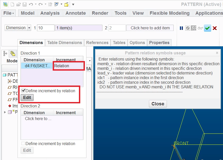

edit pattern definition and set relations. See following picture taken from CR2.

Hey Martin,
Thank you for those pics.
I have found out that option to go to relation.
I am not able to successfully create a relation with those variables.
