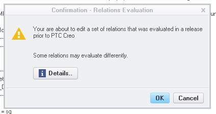

When adding a relation to a part this morning, I got this message:
"You are about to edit a set of relations that was evaluated in a release prior to PTC Creo."
On one hand, I understand this, our start part was built in WF5, this is Creo 2.  On the other hand, I've been working with these models all week (and with these start parts for months) and I've never seen this error before.  This particular part was created in Creo 2 and regenerated in Creo 2 many times.
Likely not an issue, but I wonder what changed that triggered this now.  Anyone have any insight?

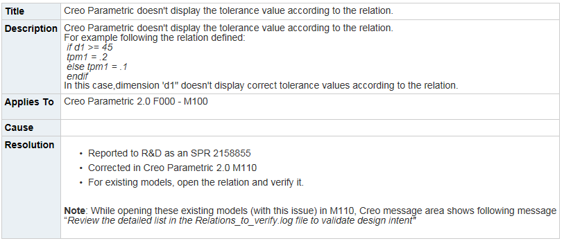

There was a bug with angle dimensions that was identified and fixed.  As I recall, a relations_to_verify.log file gets generated identifying potential problems.  When I checked my .log file, I saw that all the dimensions it was flagging were angular.  I just verified that all the values were correct and went on my way.

That makes sense, I had just added a relation on an angular dim by typing in a parameter name while editing the dim. and saying yes when it asked if I wanted to add a relation.
Do you know what build of Creo 2 fixed it?
