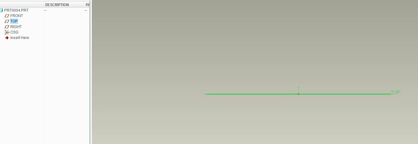

Hi everyone,
 i required Rename Datum plane using mapkey. i using method record mapkey
FIND >> (LookFor)DATUMPLANE >> (Value)Req Datum Name.
this way some times not working.
FYI. See my reply image
in mapkey scripted as per below.
 search "top" datum plane and rename as "xtop"
but in trail.txt it shows mapkey ended with only search. so its not able to do "redfine" or "editproperties" command.
help!!! urgent requirement.

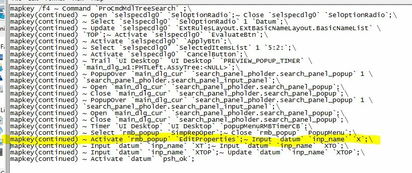

Best answer by jbob
try this mapkey
mapkey r/d @MAPKEY_NAMErename top datum plane;@MAPKEY_LABELrename datum;\
mapkey(continued) ~ Command `ProCmdMdlTreeSearch` ;~ Open `selspecdlg0` `SelOptionRadio`;\
mapkey(continued) ~ Close `selspecdlg0` `SelOptionRadio`;\
mapkey(continued) ~ Select `selspecdlg0` `SelOptionRadio` 1 `Datum`;\
mapkey(continued) ~ Update `selspecdlg0` `ExtRulesLayout.ExtBasicNameLayout.BasicNameList` \
mapkey(continued) `TOP`;~ Activate `selspecdlg0` `EvaluateBtn`;\
mapkey(continued) ~ Activate `selspecdlg0` `ApplyBtn`;~ Activate `selspecdlg0` `CancelButton`;\
mapkey(continued) ~ Command `ProCmdRedefine` ;~ Select `Odui_Dlg_00` `pg_vis_tab` 1 `tab_3`;\
mapkey(continued) ~ Input `Odui_Dlg_00` `t3.datum_plane_name` `xtop`;\
mapkey(continued) ~ Update `Odui_Dlg_00` `t3.datum_plane_name` `xtop`;\
mapkey(continued) ~ FocusOut `Odui_Dlg_00` `t3.datum_plane_name`;\
mapkey(continued) ~ Activate `Odui_Dlg_00` `stdbtn_1`;

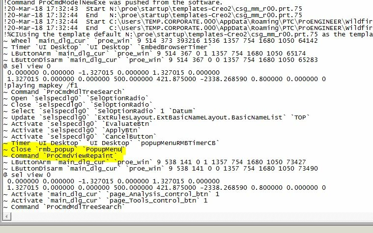

Mapkey run full length its not failing, but its not rename desired plane.end with selection mode.
dg-21-VisitorAuthor
March 20, 2018
i checked trail.txt file mapkey not run the full script
MAPKEY
dg-21-VisitorAuthor
March 20, 2018
Trail txt image.
FYI. See above image and this image attachment also.

jbob12-AmethystAnswer
March 20, 2018
try this mapkey
dg-21-VisitorAuthor
March 21, 2018
Thank you so much.
its working Great.
let me know whats mistake of mine.
