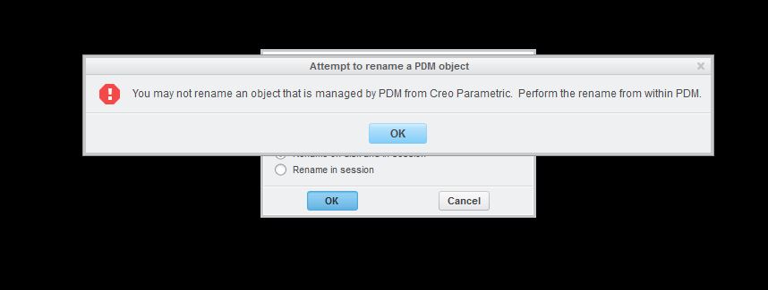

I am trying to rename parts/assemblies on a project someone sent me. But I do not use PDM, so this is the error. Does anyone know how to "unlink" the files from PDM? I am still searching the help files and the menus.

There is a config.pro option.
let_proe_rename_pdm_objects YES

That does it, thanks.
