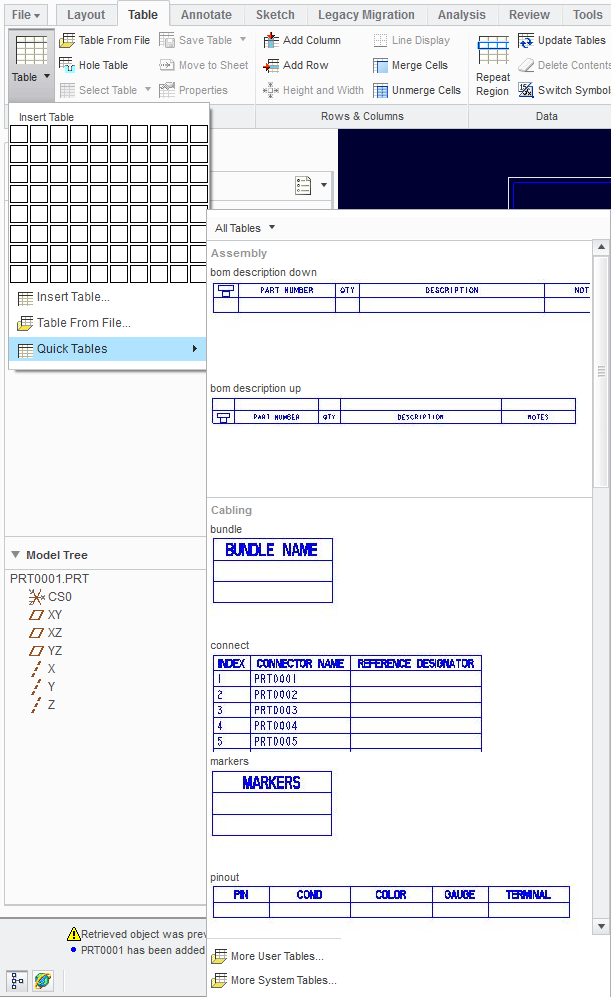

Grahame,
If you are on Creo 2.0 or higher, there are predefined tables with repeat region. Try to put one of these into the assembly drawing and see what you get.
