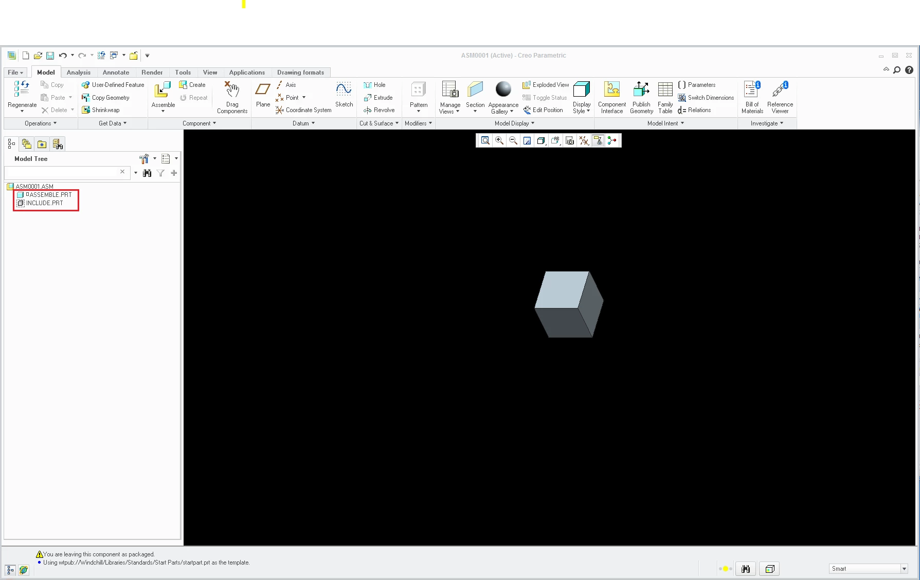

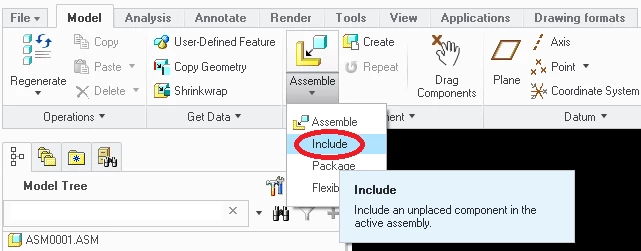

What I'm really looking for is a field that displays "No" for components that are included in the assembly, instead of assembled. This is done in assembly mode by clicking the arrow under the "Assemble" button and then clicking "Include." This step is shown in "include.png." Included parts in an assembly do not display their geometry in the assembly, and they show up in the model tree as seen in assembly. In he attached "assembly.png," ASSEMBLE.PRT is the cube with the visible geometry, and INCLUDE.PRT is the part that is in the model tree, but not seen in the drawing. As you can see from the model tree of the assembly, the symbols for an included part and an assembled part are different. However, in a drawing, both included parts and assembled parts will appear in the BOM.

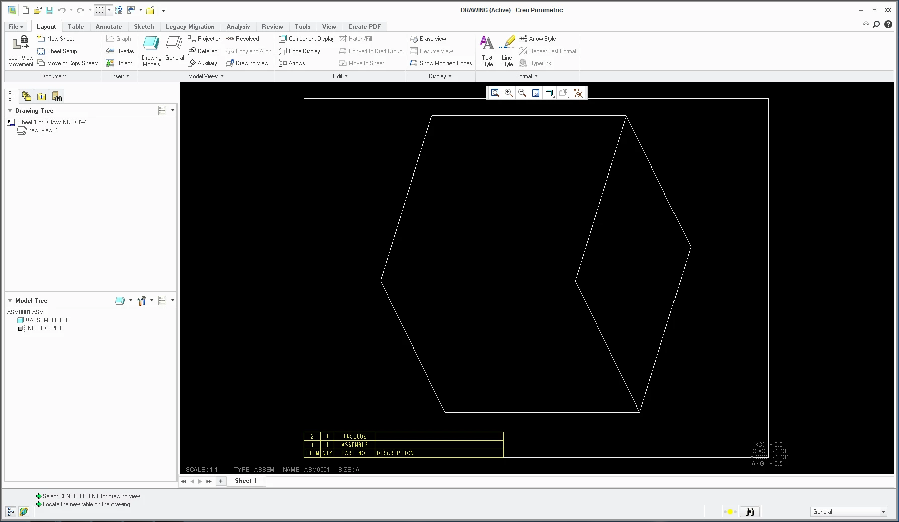

I've also attached a picture of the drawing with a BOM in it, to show how this assembly will appear in a drawing.

William,
I don't see any quick&simple solution.
You can create string parameter PARYESNO in your models and put Yes/No value in it manually and show the parameter value in the Repeat region.
You can use Search tool in Assembly mode and find Included components using rule Relation is equal to Unplaced. Then you can select all found models, press RMB in Model Tree and use Edit Parameters command. Then you can modify the value of PARYESNO parameters in single window.
You can also create a layer defined by rule Relation is equal to Unplaced.
Martin Hanak

The solutions posted are able to work. Since a lot of our drawings have BOMs that have parts not shown in the assembly, I hope we could see an automatic relation added to a future release of Creo Parametric.
