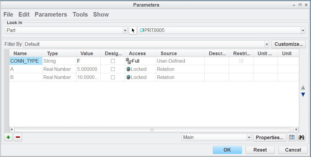

November 30, 2016
an example follows ...
CONN_TYPE parameter is restricted and is not locked
A and B parameters are note restricted and locked (because they are used in relations)
MH
November 30, 2016
Sorry.... when I said "Locked" I'm refered to column "Restricted"
I don't click for restricted, when I created the parameter
You have created a CONN_TYPE ... How could you restrict it?
BR,
Gorka Garcia
November 30, 2016
you have to define restricted parameters in special text file and put the path to this file as value of restricted_val_definition option in config.pro file.
MH
