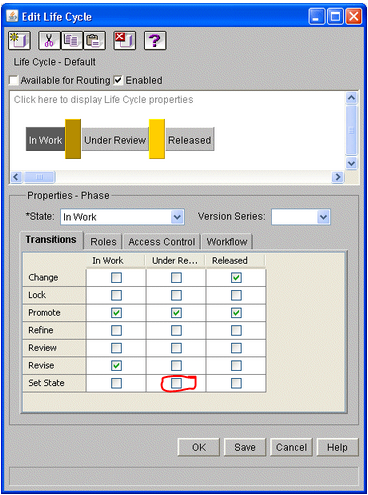

This is controlled by the lifecycle template currently applied to your CAD Documents.  It's very simple to adjust this to allow users to set state to "Under Review" (or anything else you might want).  See the Windchill help for "Understanding Life Cycles"
