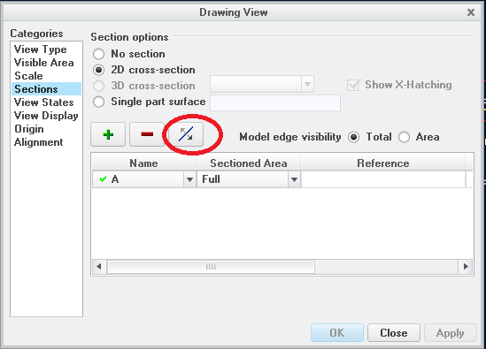

In your model, redefine section a to be on the correct plane that is parallel to the view you want it to be on.
Or are you trying to show section a-a in a non-orthographic projection location? In that case, take your top view which shows section a-a, make it a general view an the rotate the view to the orientation you desire.

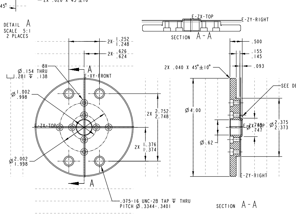

When I do that it only displays half the view and not the section I want.  See attached.  What I want is on top, but I would like to rotated that 90° Clockwise.  What I get when I place the general view as a right view and then apply my section is on the right.  It simply cuts the top half off with the section plane.  VIEW ROTATED.jpg

So I took a part I had and created a new general view, not projected, rotated it 90 degrees then applied the cross section
I left my planes on so you can see how I placed my view (upper right)
Is this what you are trying to accomplish?
--as a thought while I was doing this, in your example, did you flip your planar view to see if that was the problem
just thinking... which is a dangerous thing for me to do!
