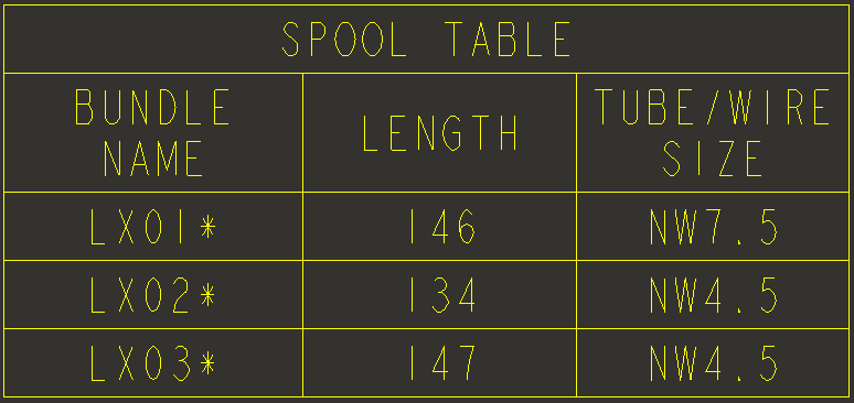

Hello Experts,
Is there any option to round of the bundle length values to nearest 10's. i.e 1674 to be 1670.
Able to control only decimal places in repeat region.
Please advise if anyone know the option.
Vijay K G
Best answer by MartinHanak
I added new drawing version to your dataset. I slightly modified repeat region relations and repeat region table. I used Creo 3.0 M100.

I hope you can achieve your goal, if you implement repeat region relations.
Please upload example files. I will create relations for you, if you want.
Use How to Attach a File to a Discussion Reply procedure to upload data.
MH

Request you to create relation for this subject. Attaching herewith sample harness drawing with spool table.
Below is the default values which getting from the harness file.
I would like to have length values in 10's as follows,
146 -> 150
134 -> 130
147 -> 150
Vijay K G

First, I would not recommend to ROUND DOWN on any cable length...you will be hitting your head against a wall if your cable is too short.
The calculation (ROUNDING UP) is simple:
CABLE_LENGTH = 144
ROUNDOFF = 10
CABLE_LENGTH_COR = CEIL(CABLE_LENGTH/ROUNDOFF)*ROUNDOFF
