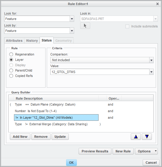

We have a layer called Datum that has a rule in it that all created Datums shall get added to it automatically.  The rub comes when one of the datums you create turns into a set datum for Gtol's .   We would then like that datum removed from Datums and added to Gtol_datums. Is there any method to make this happen automatically ?  And if then rule setup is what is needed for layers

This is the rule for the Datums Layer that excludes datums that are added to GTOL DATUMS layer

‌You can create a rule for the Gtol_datums layer that searches for the set datums. For the Datum layer you can create two rules with an AND condition, rule 1 search for all datums AND rule 2 search for datums not included on layer Gtol_datums. Others may have other rules they use.
