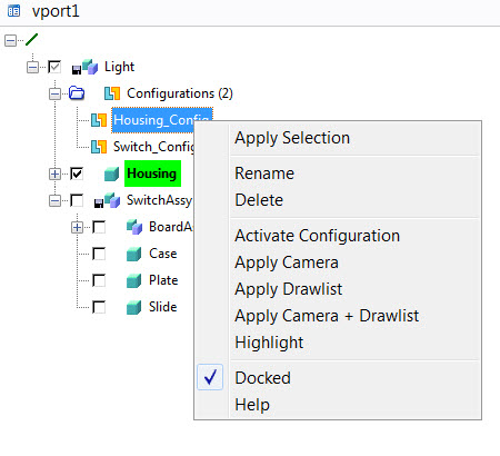

Another option to Snapshots in Model Manager is to create one or more Configurations under the assembly.  Each one can have its own hide/unhide set.  With a right-click on the configuration, you can capture the camera angle, the drawlist (hide/unhide), or both.  After it is created, with a right-click on the configuration under the assembly, you can apply the camera, the drawlist, or both.
