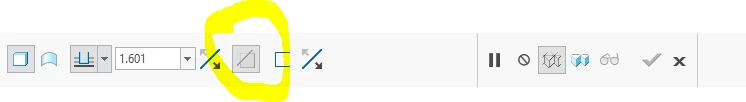

Hey there,
I have a step model which is only one part. I would like to cut this model and save on of the parts. I already created a cut so i can see just one part of the modell. But if i save the projekt, the modell is not cut.
Who can I save the cut view?
Thanks for anser.
Best answer by Dale_Rosema
Start an extrude. It is in the main tool bar.
With assemblies, you can only do an extrude cut (you cannot add material in assemblies).
