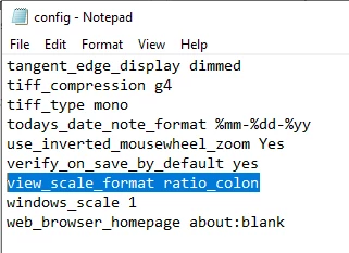

Our config.pro has view_scale_format ratio_colon (1:1) which does not seem to be mapping across correctly

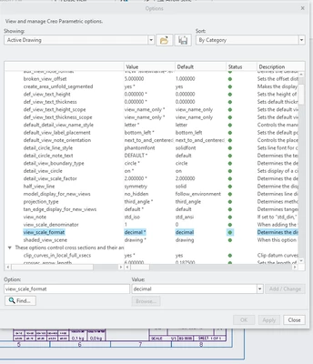

In Prepare>Drawing Options>Detail Options> view_scale_format is default to decimal* (1.000)

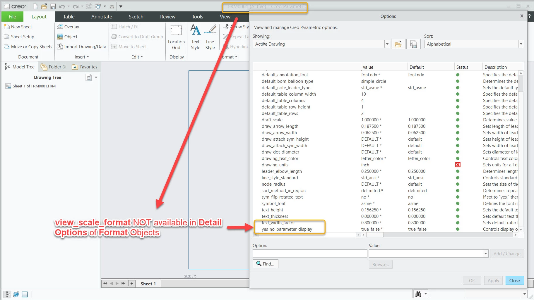

No. You cannot configure this at format level, because Details Options (access from >File >Prepare >Drawing Properties >Drawing Options >Change) does not even propose any entry labelled view_scale_format in the scope of formats objects (upon definition or redefinition), and this is expected (see attached snapshot).
As a setup for the future to get this automatically (without having to notify users each time), you have therefore no other choice (as far as I know) than configuring it in your Drawing Template Object (where template_drawing config option can later point to). And this Drawing Template can be preconfigured with the format (from *.frm file) you want.

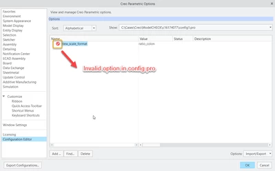

view_scale_format is a DTL Option (in Drawings), not a valid config option. I tried to check one very old version of Pro/ENGINEER, and it was also not allowed (check attached snapshot), so not a regression for sure (but may be an intentional change of behavior if this was supposed to be handled by config.pro setting in pre-Wildfire 3.0 versions, not sure here ...).
In your first snapshot, you show presence of this option withing config.pro in a text editor, but I suppose that if you access >File >Options >Configuration Editor and scroll down to this option, you will probably see something like this (please confirm):
Therefore, there is no other choice than driving this behavior from DTL settings (>File >Prepare >Drawing Properties >Drawing Options >Change), according to guidance documented in Detail Options section (near the end of the page) of Creo Parametric 8.0 Help Center.
Considering above, how to deal with this now?
  • For new drawings, it's easy: Just configure the expected value of view_scale_format in your drawing template object, according to guidance in articles 120556 or 33947
  • For existing Drawings (containing wrong definition of view_scale_format), consider a mapkey which will change this to reconfigure the value of thid DTL entry according to what you need.

Thanks for your reply, the Configuration Editor does show as in your screenshot.
