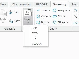

I do not know much about the Creo Schematics. My company uses Eagle and Gerber files. With Creo Schematics software, can I import in Eagle and Gerber files into Creo Schematics? Can I export out these file formats out of Creo Schematics?
Best answer by Gaby_K
Creo schematics does not support these file types
Supported files for import :

I am using Creo schematic 3.0. We are very new to use creo schematics. Can we import .she file into schematic? That option is not available. If so, please let me know how to import the file.
Secondly, How can i save sample catalog locally?
