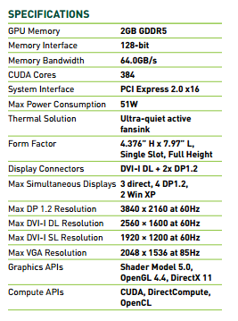

What happens at 1920x1080 res? And yeah I'm not sure a K2000 is going to push 2 monitors at 3840x2160 well. Maybe someone else is doing it can respond.
February 20, 2015
If I'm reading NVidia's spec correctly, it looks like it should be able to drive 4 monitors simultaneously at that resolution (via Display Port).

Whilst reading the Nvidia spec is interesting it reveals little beyond the fact that, yes, its possible to run 4 monitors via display port. When you actually load a CREO3 model and try and view and manipulate it the story is, for me, somewhat different. It runs slow, such that using a 3dConnexion spacepilot is pointless as the model lags so much. Touching the display settings under Options was for me a mistake as it is now poorer that before and I cant get back to the original settings. Any sort of lag is immediately noticeable with a spacepilot.
I am not in any way certain this is a Creo or nVidia problem. of course it may be a hardware issue. But I have the latest nVidia driver, 32Gb Ram a 4 core Xeon processor that is currently 4800 on the cpu passmark charts in a Dell T5400 with Windows 7 Ultimate fully up to date.
I assume others are, or soon will be using a similar hardware configuration and its important users know what limitations they might face.
