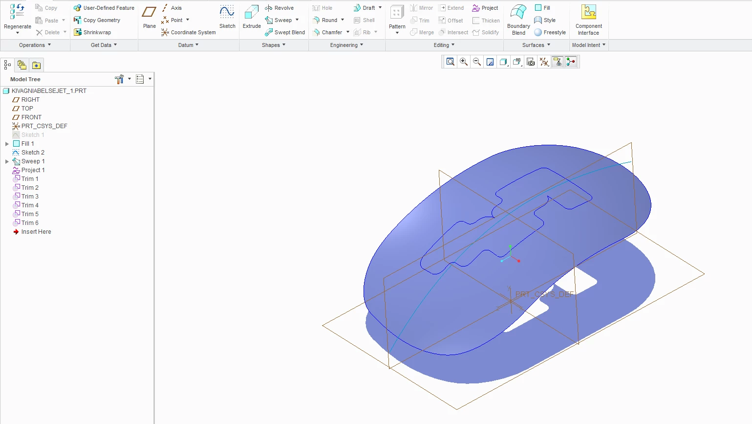

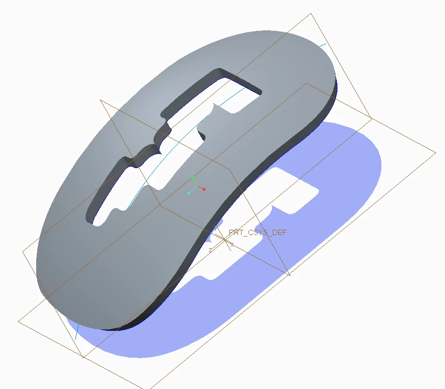

I'm assuming that you've created a sketch of that shape and projected it onto your swept surface.
Instead of projecting the sketch, use an extrude feature to cut the center of the swept surface out.  If your sketch plane is normal to the projected direction, you can simply use the sketch.  If not, create a new sketch and use the project feature on the original sketch loop.
