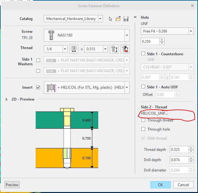

I'm in the process of switching to Creo4 and was wondering how to make the insert row the same width as the other rows. I tried copying over my screw_dialog.res from creo3, but it had no effect.

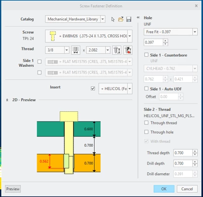

Best answer by OliverGräbner
find attached the new res file.
OliverGräbner
October 4, 2017
this is fixed in Creo 5.0.
Find attached the new screw_dialog.res file.

Thanks alot Oliver. Is it possible to expand the thread series name like you were able to for CREO3?
OliverGräbner
October 9, 2017
