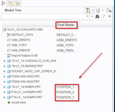

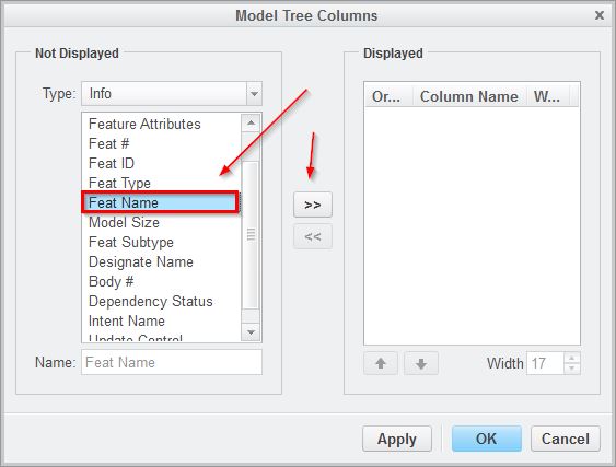

Try this:
1 - Add column "Feat Name" to your modeltree;
2 - Add unique names to each of part placements;

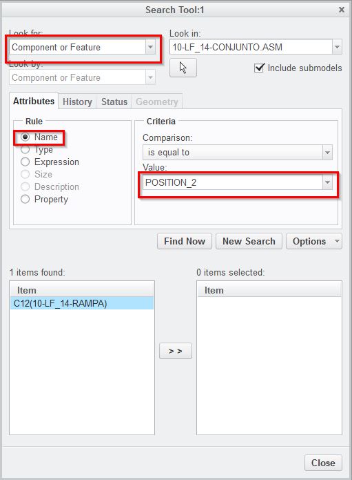

3 - Use the Find tool to locate them.
Hope it helps.
Jose

The M94 and M99 are the Feature ID. These get assigned automatically and can't be changed. It's hard to tell since you can't read the numbers from the images but at first glance the reason you don't see M94 and M99 in the 1st and 5th  image is because they are images of the first row instance in your table which shows those components are not used not the second row.
September 15, 2016
Try this:
Hope it helps.
Jose

Thanks....thats what I was looking for.
