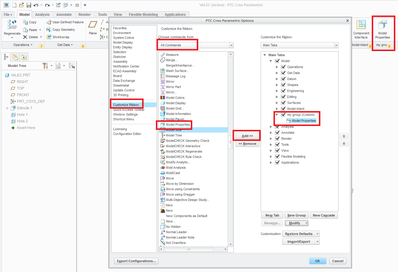

In Creo 3.0 I have more the icon that allows to assign certain functions to
the piece under construction, or material, its units and others.
I remember his name to find it in the list of
functions that can be added in the menu bar.
Kind regards.
Denis
    Best answer by MartinHanak
    What about this ...

    Hello Martin
    It is both simple and difficult to explain.
    When you start to build a new piece, in line with the function icons there is an icon, I do not have the name, when clicked it opens a window menu in the how we can define the material, units, and several other things.
