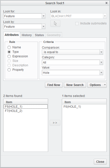

I got a yellow error while regenerating an assembly. It said Hole_105 lies outside the model or something to that effect. My problem is I don't know how to search for Hole 105.

to find hole - you should do as at the image below. select your HOLE 105 and move to the right, close search window. having still hole selected RMB > Locate in model Tree (available only in part mode)

Look in the message log or the trail file to better locate the problem.
