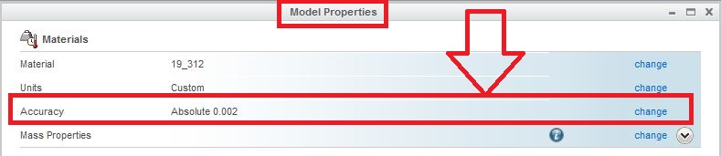

Hello jeremy morgan
first what is going on my mind is: different Model accuracy.
File - Prepare - Model properties
Try to set the same in original and target part.
Regards
Milan Bonka
