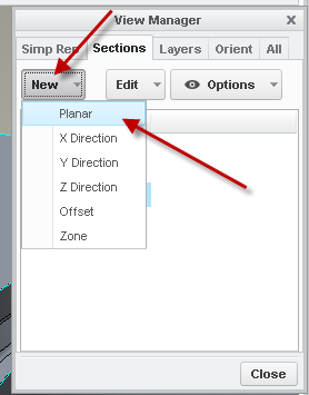

First time poster, not sure if this is in the correct place.
I'm using ProEngineer Wildfire 2.0.
Is it possible to view a section of a solid along a datum plane?
i.e cutting a solid in half to look at geometry that you can't easily see when the solid is 'full'.
Thanks in advance,
Mourad
Best answer by StephenW
right mouse on the section, activate
We just discussed a similar problem How to clip parts that lie across cross section planes?
It was a graphics driver issue. Maybe you are having the same problem

I don't know for sure if this will work because I've never used Wildfire 2.0, I started on Wildfire 3.0, but I believe that if you go to View>View Manager>Xsec you should be able to create a new planar offset.

Search the help for cross section or section. As Tyler said, the menus may have changed since Wildfire 2.
On the current software, you define cross sections in the VIEW MANAGER

Hi there,
I am able to create cross sections just not able to actually clip them.
