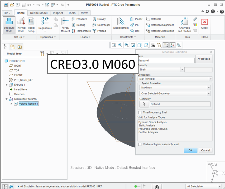

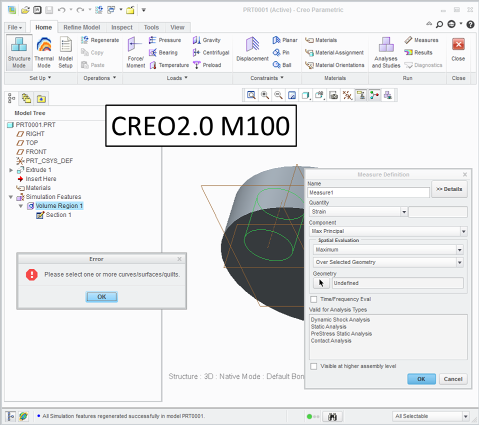

Please confirm that it's not possible to select a Volume Region in a part for a Simulate measure of Max Prin Strain while in Creo Parametric Simulate 2.0 (m120) ?
Trying to use a volume region for a feasibility study where a strain measure tied to a volume region.
This selection works in Creo Simulate 3.0 but appears not to be available in Simulate 2.0

Don,
I cannot in 2.0 M100
I can in 3.0 M060
Looks like a Creo 2 limitation.
bfn
Charles

Don,
I can in 3.0 M060
bfn
Charles

Charles,
The only way I found that I could do it was to first assign the volume region to a layer and then select the layer for the measure.
August 3, 2016
Don,
Nice one.
Perhaps you should mark yourself as correct and get the star for tenacity?
