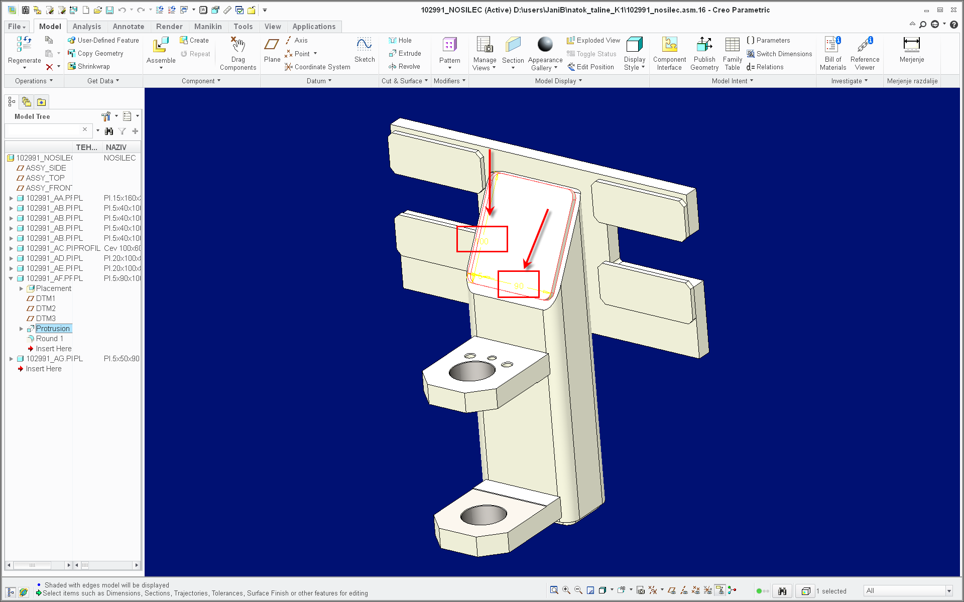

Hi all!

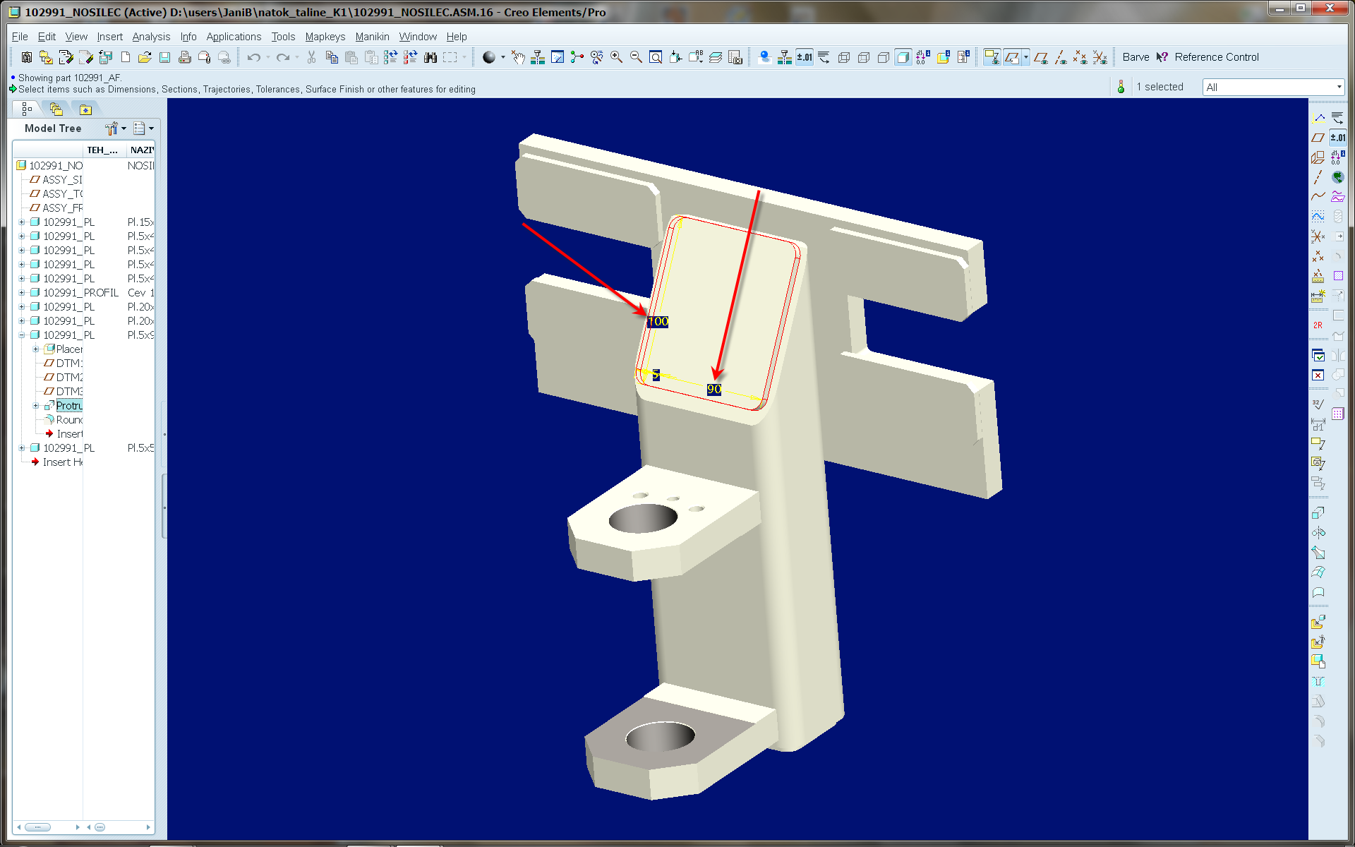

In proengineer wildfire 5.0 when I selected a feature with right mouse button and then pressed edit, it showed dimensions with a black shaded background.
Picture bellow:
When I do the same thing in Creo 2.0 there is no shade on shown dimension and the dimension values are poorly visible.
Picture bellow:
Is there a config.pro or any other option that will allow me to turn on this shading in Creo 2.0?

Best answer by MartinHanak
Matevz,
try the following config.pro option:
enable_transparent_text_bg yes
Martin Hanak

January 28, 2015
This is what I was searching for.
Thanks for your help and quick response!
Matevz
