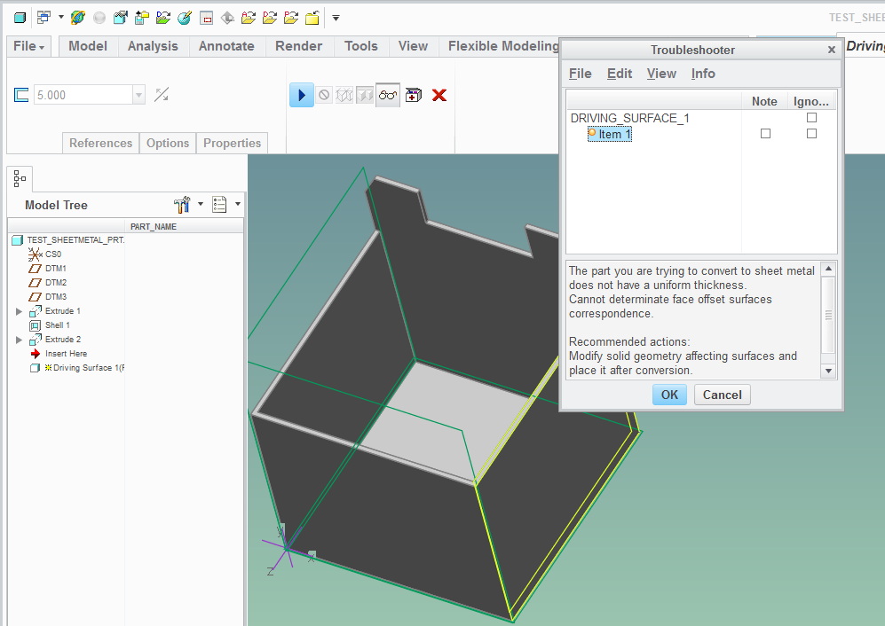

An engineer who is new to Creo Parametric sheet metal module has has asked me this seemingly easy question:  Why can't he convert this part made in standard part-modeling mode to sheet metal:
The failure diagnostic mentions non-uniform wall thickness.  Yet it's hard to explain why that is.

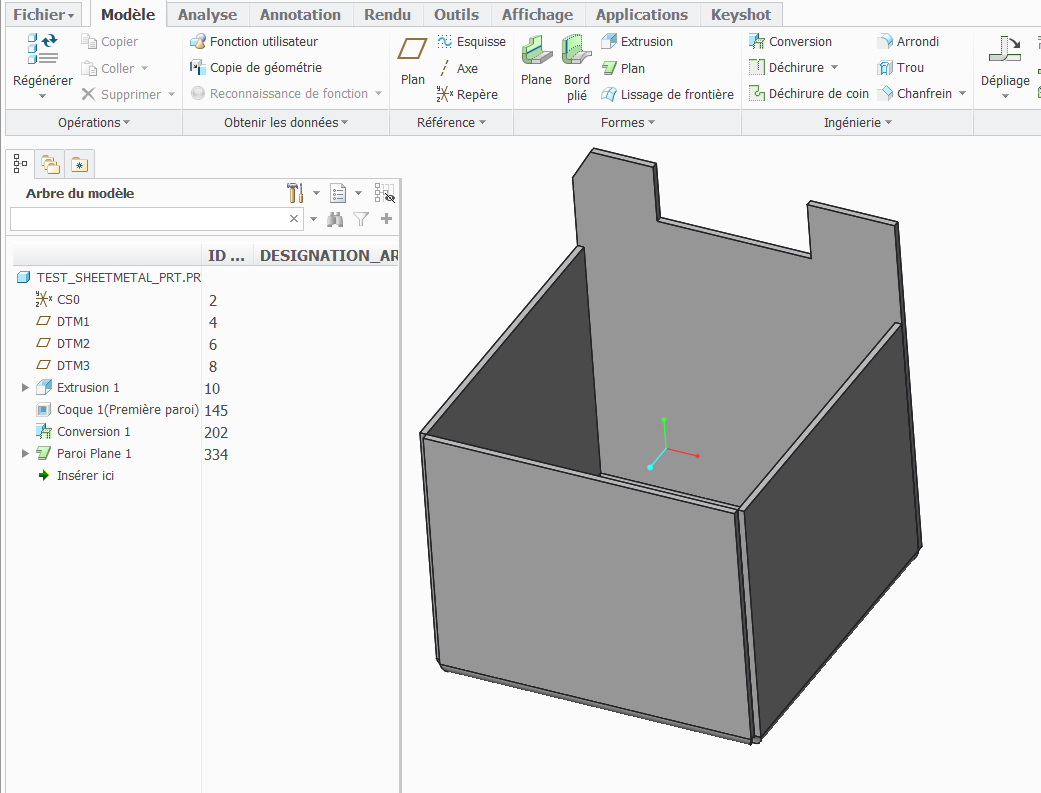

Hi

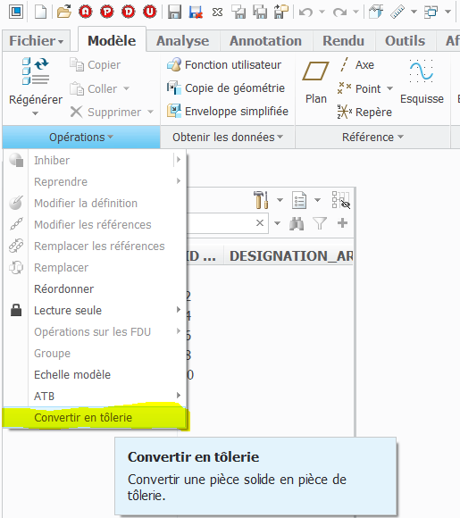

I don't have links to give but in this case the method is not good. You must not use the shell function in solid part. You must use the shell function located in the solid => sheetmetal conversion.
Then you must use this other conversion tool to define seems and bends.
Here it is !!
You'll find attached the modified file that works fine.

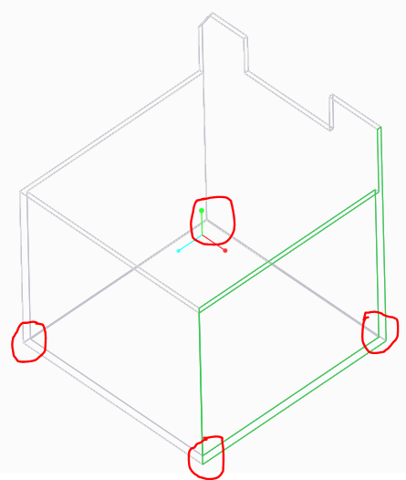

September 21, 2016
To convert a solid part to sheetmetal using driving surface, it requires that the model have a constant thickness. In this case thickness is not constant because of the corners I surrounded below.
