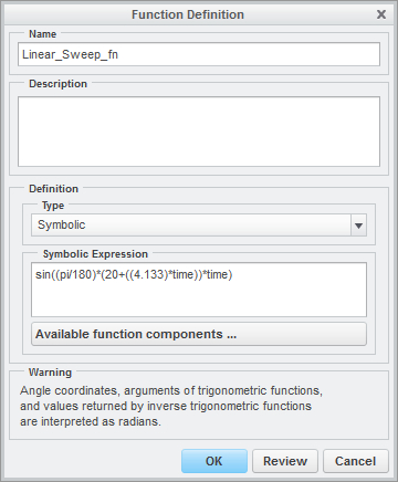

Hello.... I want to simulate a sine sweep in Dynamic Freq. analysis.  I thought it would be easy to input it with a symbolic expression. I tried several expressions, all with no luck.
I want   F(x) == Constant*sin(x).
How does one put that into Creo???
Thank you

rhilson1-VisitorAuthor
March 20, 2017
Good Morning Paul.
Thank you very much.  "frequency" is the word.  I was going nuts trying to do this.

I used a linear sine sweep function, but logarithmic is also an option. My frequency range was from 20 to 2500 Hz, and the time to sweep this range was 300 seconds. See the link for explanation of the function. https://dsp.stackexchange.com/questions/13514/how-to-estimate-the-frequency-at-certain-time-of-linear-sine-sweep
