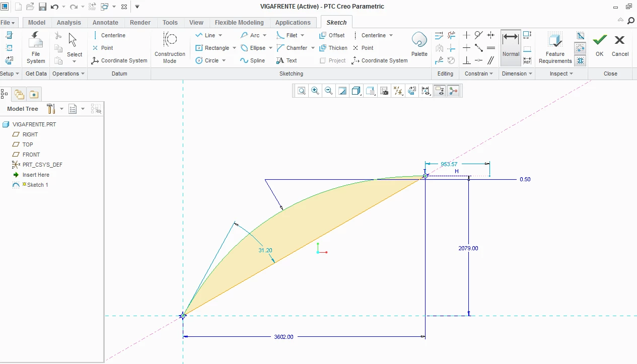

Hi !
I would like to change the dimension of a conic arc ? I only obtain the angle and diameter ... I would like to get the length.
Thank you
work with PTC Creo 3.0

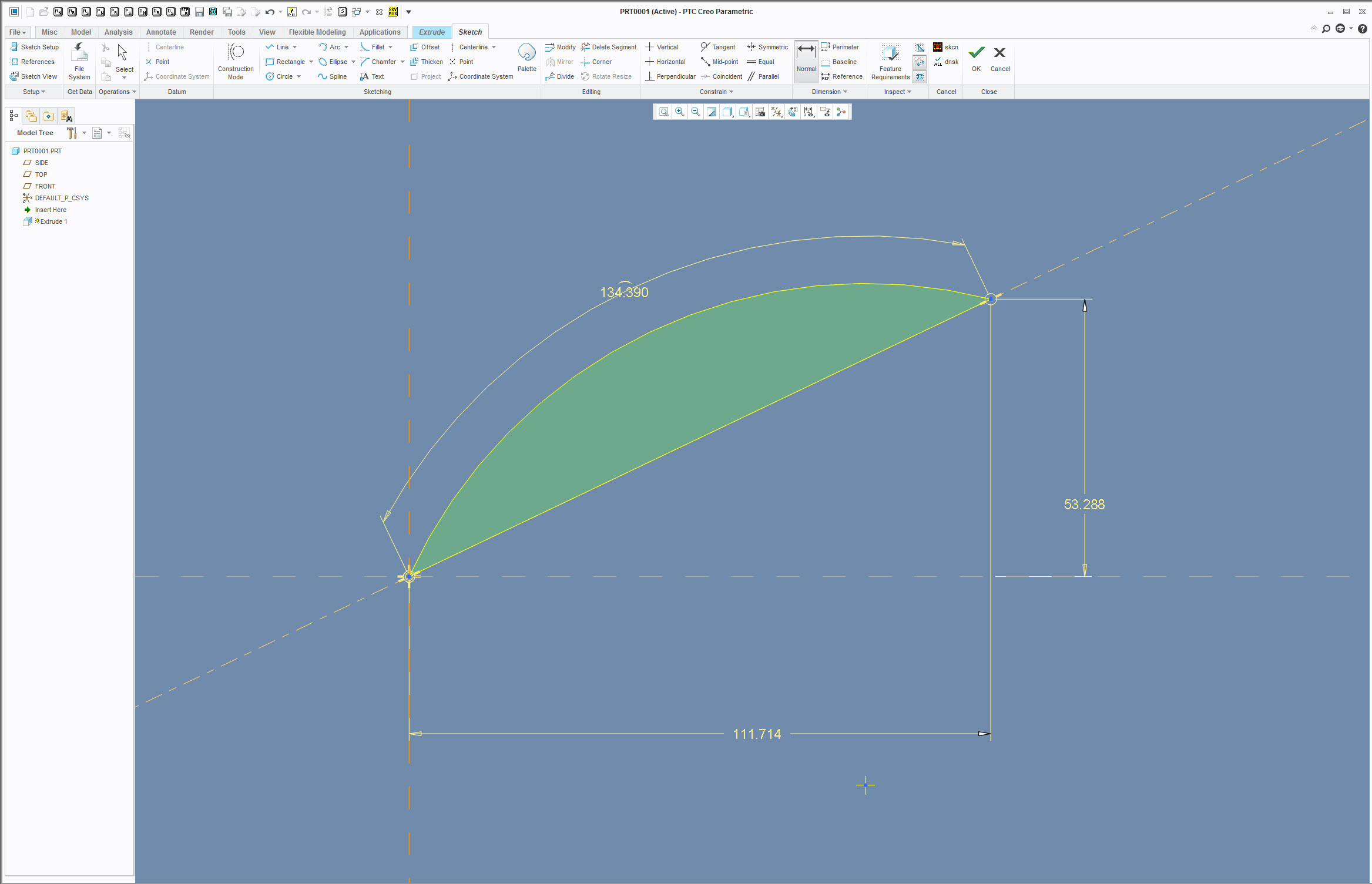

When dimensioning, if you pick both ends of the arc, followed by a pick of the arc itself, you will get a dimension as shown:

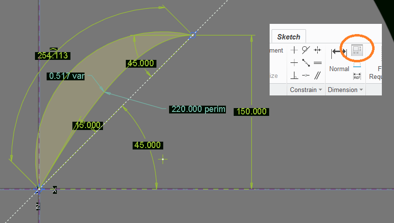

psobejko1-VisitorAnswer
February 20, 2017
You can dimension a perimeter of a circular arc in such fashion.  But for the conic one, you need to use the perimeter dimension that others mentioned:
Two points I'd like to mention:
1) only one perimeter dimension per sketch is allowed (hence the grayed out icon)
2) I had to make all sketch dimensions strong (green color) prior to selecting the conic arc, clicking on the "perimeter dimension" icon and then selecting the conic factor dimension.  This dimension then has var appended to it (for "variable").  Initially it was 0.5, then it changed to 0.517 when I specified the perimeter to be 220.
