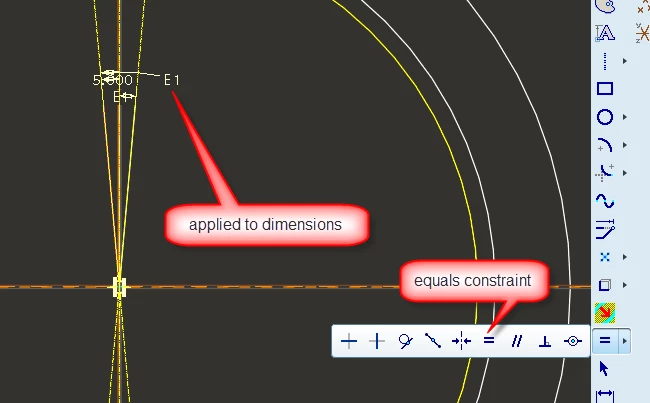

If you are in WF5 (WF4 too??) you can use the "equals" constraint on
dimensions as well as entities.
-Nate

Nope - doesn't work in WF4:
July 27, 2012
The equal constraint doesn't work on dims in WF4, that was new in WF5.
However, you can create relations in sketcher. Click tools -> relations
and the dims will flip to show their symbols and you can write a
relation like sd1=sd2.
