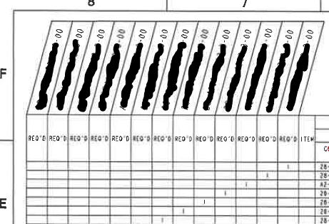

I am manually creating a table that is supposed to match one on a reference drawing.
Does anyone know how to create slanted/angled headers for a table? It is supposed to look like this:
any suggestions?

Yikes!  It's definitely cheating, but maybe you could make the row height for the top row so small you can't see it (the text will still extend up okay), put a slant angle on the text, and then draw the outline of the angled cells with either sketcher or a custom symbol.

This was a CAD drawing, though I'm not sure which interface/program was used to create this.
Creating tables like this is per request from a large customer we have - not sure if there even is an ASME spec regarding slanted cells.
For the time being, I am just creating the table with vertical headers.
Sketching in the angled cells seems like it would be more trouble than it's worth in the future iterations of the drawing.

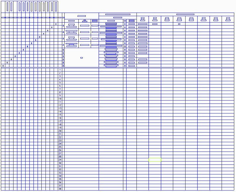

An auto-fill table template would be SO NICE for creating drawings or assemblies that have 7, 8, or 9 iterations of a single assembly.
This is what we're filling in and creating, by hand.
