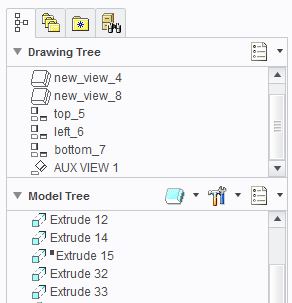

Is there a way to view the model tree and the layer tree at the same time in CREO 2.0?  Ideally this would be a split column similar to how in drawing you can see the drawing tree and model tree.
