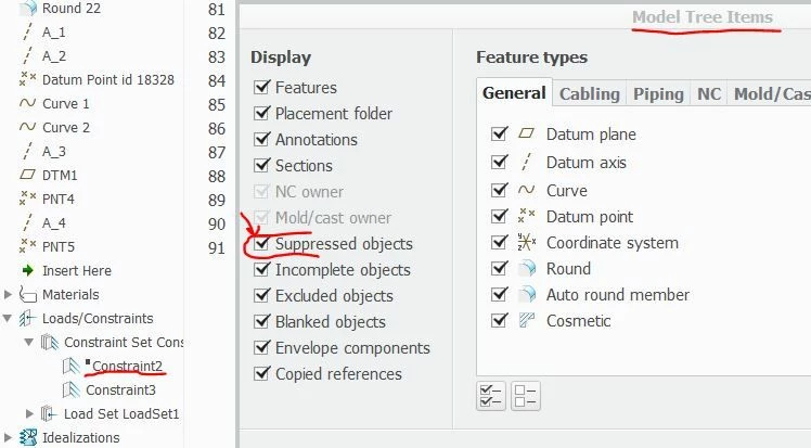

I have a problem with CREO Simulate: when I suppress an element of the model tree (a load, a constraint, a connectio,...) it completely disappears from the model so it is impossible for me to make the resume of the feature and it is more like I had deleted it.
Is there a way to fix this inconvenient?
Thank you very much for the help!
Best answer by skunks
skunks
skunks19-TanzaniteAnswer
July 24, 2017
July 24, 2017
Ok done! thank you!
