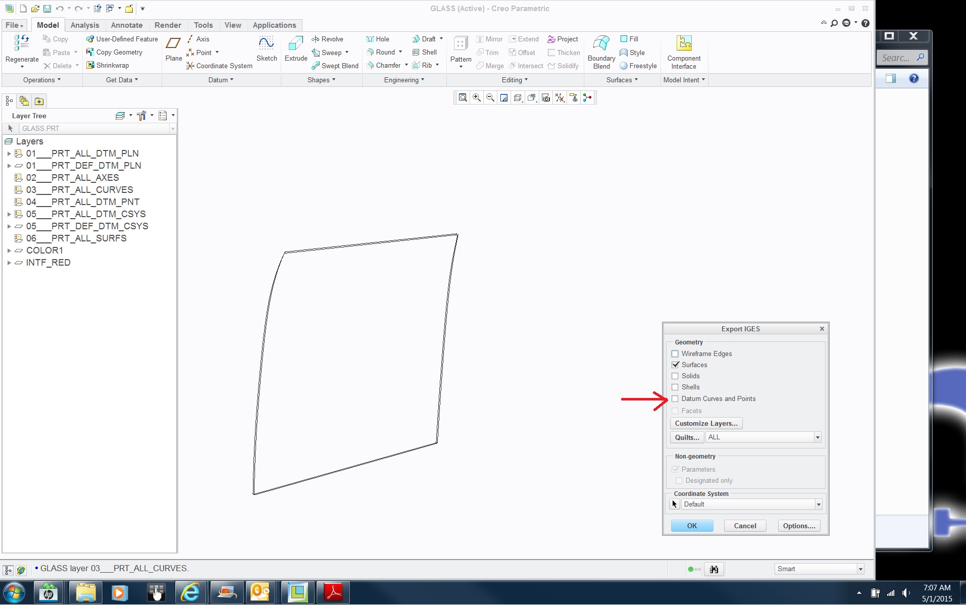

May 1, 2015
Save this as an IGES with curves. I only have Creo2.
I have done much surfacing (BIW, glass, etc...) on Pro (A.K.A. Creo)

May 1, 2015
Need curves too.
